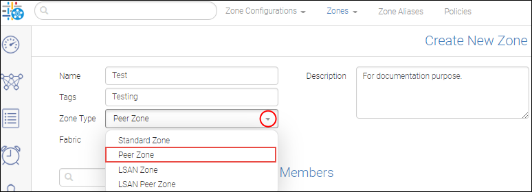

4. Enter a name for the zone, along with any tags and description.
5. Select Peer Zone from the zone type drop-down.
6. Add principal members and peer members to the peer zone.
